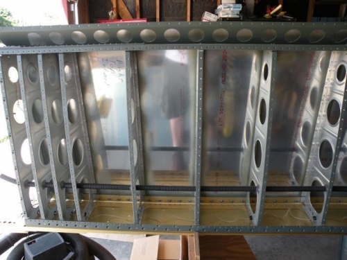

Should have posted these first, before the previous post. These were taken during after clean up and primer. In process. Just getting ready to start installing new skins. Some piece parts haven't been primered yet. The camera flash and shadows plays tricks with the color

Right wing leading edge skins installed, top skins clecoed in place ready to shoot. Wings should go together pretty fast now Paul
